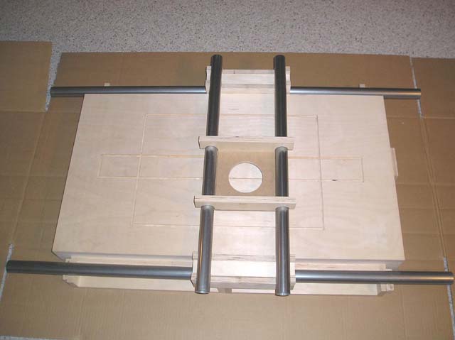

When I built my thickness jig I took a different approach. I made mine to be used with a router and vacuum suction, and designed it to handle boards up to 20"x36". This way I could mill off a lot more at once, and then just do a finish sanding.
